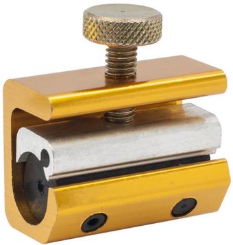

The FJ has perhaps the easiest cable system to maintain due to the spliter above the engine.  Careful disassembly exposes the cables and allows lubrication to be forced in both directions.  You need to keep track of the small pieces (ie don't drop them!) and buy a can of cable lube with the handy little seal device.  Do the choke cable while your at it.

Most bike shops will have a cable-lube tool for you, or it's on Amazon for a fair price.  Cable lube (which is NOT kerosene/WD-40) comes in aerosol cans.  The skinny red straw goes into the small hole, the cable goes into the larger hole.
