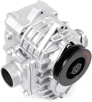

The funny bike idea looks outrageous!  And good!   Supercharger or turbo?  I'm assuming conventional ignition vice the dual magnetos driven off the right side of the crank?  Car tire or a 240 or 300 on the rear?  Lots of possibilities....
freakhousecustoms
Have you seen these "AMR 500" superchargers?  Tiny little things that come off some 1.3L truck in Japan.  Tons of moto-guys are using them, they're stupid cheap with like 4 moving parts in total.
Eventually I'd go turbo, but an LSR buddy of mine ran an AMR 300 on his 350cc Moto Guzzi and he was going as fast as I was (he might have even gone faster) on my stock motor'd GS1100E land speed bike!
