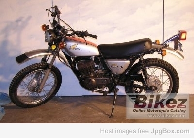

I had the SL350
What a great bike. More versatile than the CB350. I rode the hell out of it, before I was drafted
CutterBill
SL350:  The original adventure bike!

andyoutandabout
Somehow I can totally imagine Conlon on that SL 350, a young buck, hair trailing in the breeze, kinda like it does now.
