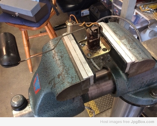

Recently I was draining a fuel tank treatment and discovered that two pieces of what appear to be factory installed heat-shrink / electrical tape flowed out of the tank. My best guess is that they were located somewhere on the fuel level sensor. Can anyone provide some steerage on where this might have come from? I have attached a picture of what I found.

How can you even get to that area? Even putting an eye on the entire fuel level float assembly is tricky, much less accessing it. I'm wondering if these were factory installed around the two leads, or some other part of the float assembly that I cannot see.

I pulled the float and sender out to clean the inside of my tank. I have a dental mirror on an extending wand and a SureFire police issue flashlight and I spent some time seeing what I could see.

The gas cap seal is in great condition, and appears original; I'd doubt that is what I pulled out. The closest resemblance I could come up with was heat shrink material.

How does one even extract the fuel sensor?
These two pieces of heat-shrink / electrical tape still have adhesive on them, so they were definitely just recently adhered to something.
Alex
1989 FJ1200 3CV
Ted Schefelbein
The sender has four bolts that retain it. You have to wiggle the unbolted base around to get the float properly lined up in the hole in the tank, and then gently work it back and forth as you are pulling up. I lubed the float and the hole with oil, the float was a snug fit through the hole. It is a plastic float, and may have expanded a bit since it was new. Expect to buy a new gasket when this is over to put the sender back in, and there will be some cleaning that needs to be done at the base of the sender, because crud accumulates there over time. Like most things, it isn't difficult, just time consuming.
