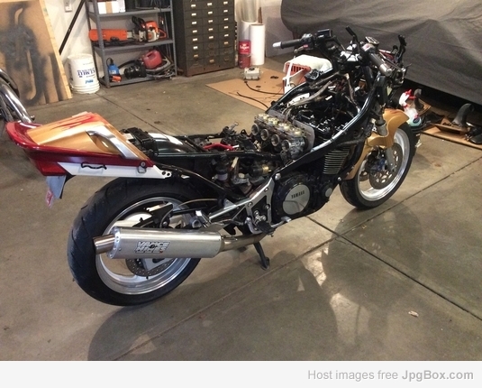

You all have a photo like this, I'm sure. Here's mine:
A red letter day. Valve cover back on. Valves adjusted, gasket and grommets replaced, actually a bunch of rubber parts have been replaced. Some aftermarket wiring bug a boos sorted and fixed, one of those (brake lights) left to sort. Dead relays everywhere, most have been replaced. I'm going to service the speedometer head and the reserve fuel contacts, as noted by others. New stuff like a petcock, rebuilt stuff like the clutch slave. After I flushed the brakes, I get the feeling those blue dot brakes are a big improvement over stock, there is a lot of positive feel in the levers.
Waiting on a Morgan Carbtune tool, and for the State to open, so I can get a plate.
Please don't feel I am being critical of what former owners did or didn't do to the bike. I'm not. I have my own way of doing things, and like everything sorted just so. One thing I changed was the way some wires were routed, put them in a cooler spot, and the wire that went to the battery for the relays just had a crimp connector, with the connector exposed. I shrink tubed that, as it is an exposed direct route to everything the battery has to give to a dead short if something grounded touches it. No sense tickling 30 year old electronic components with a dead accidental short if you can avoid it. It is fused, of course, but still something I try to avoid at all costs.

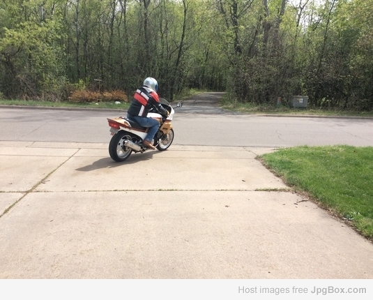

Out for a ride:
The license bureau is open for limited business, and I dropped my paperwork off thinking I'd hear from them in a few weeks. They called in an hour, so, I put insurance on the bike, and took a cool spin.
Cool refers to the 54 degree temps. Not me.
If you helped with the project, with suggestions, parts, or advice, Many Thanks.
