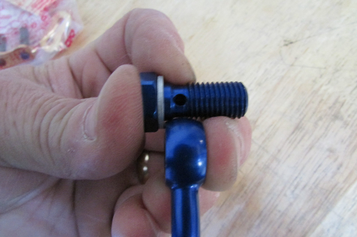

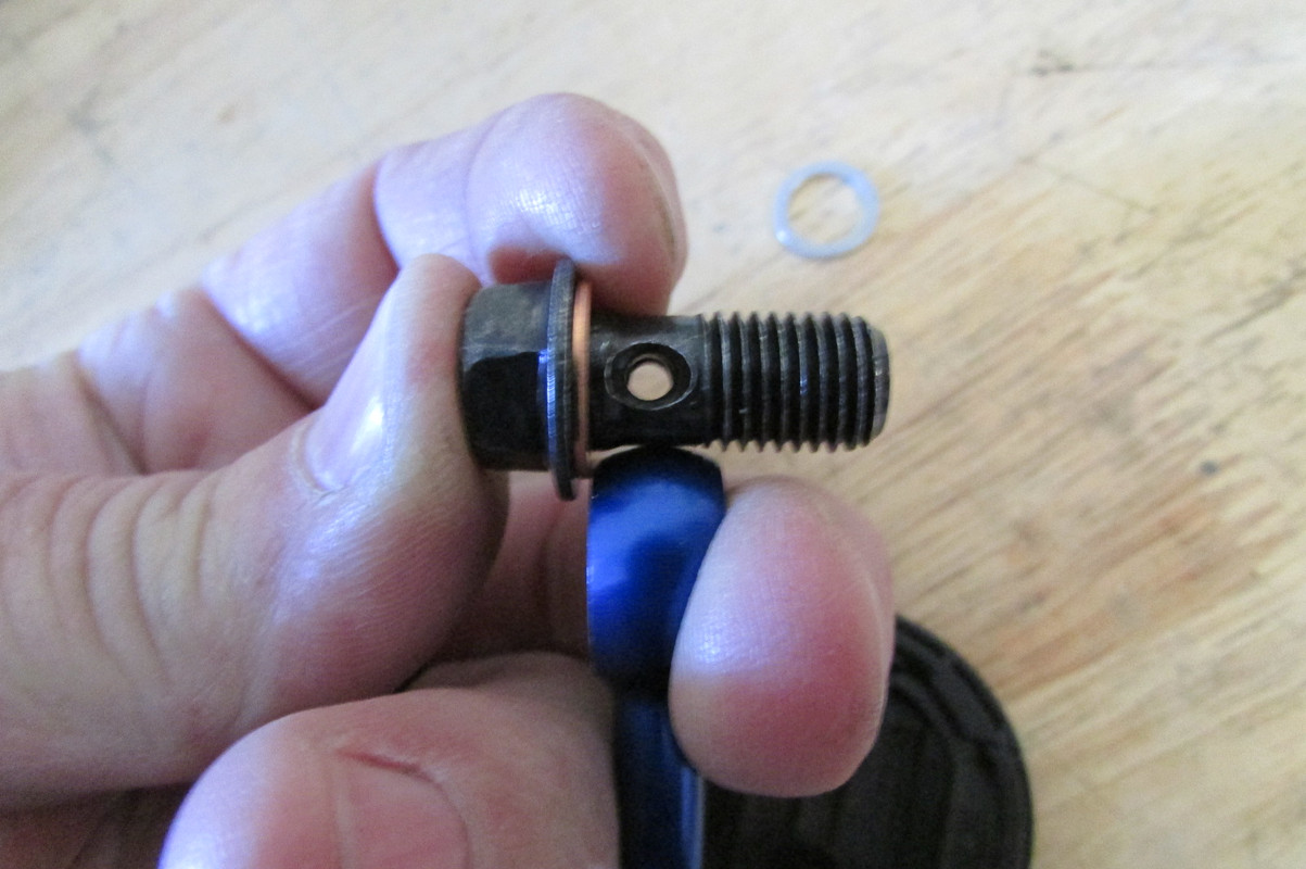

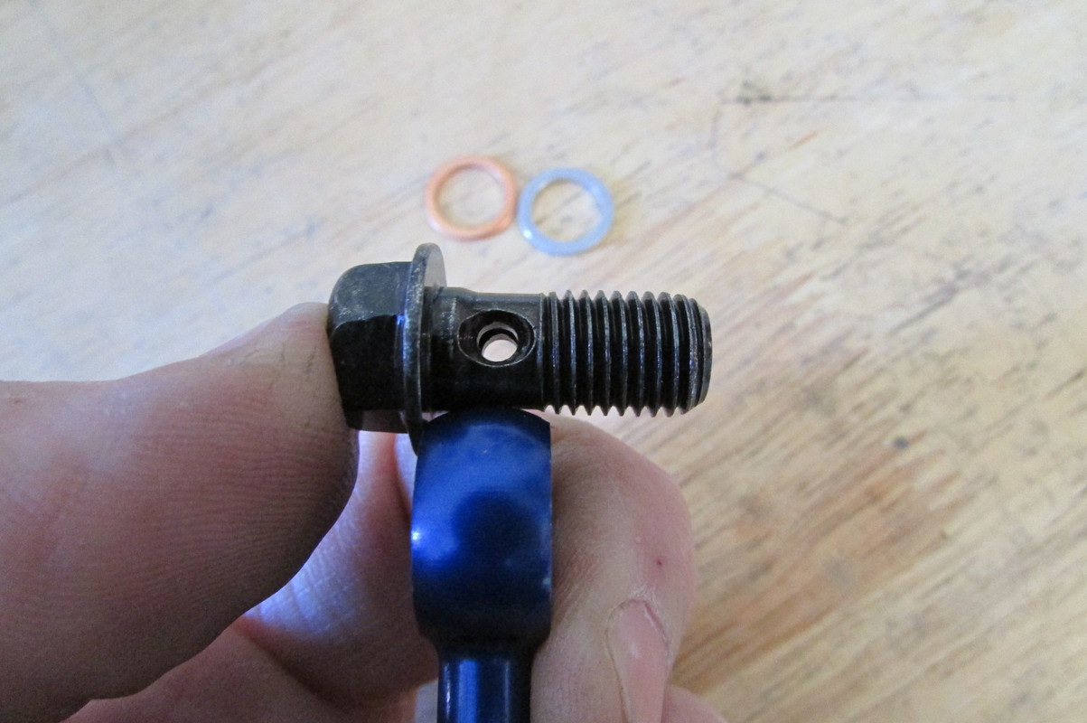

But back to your question, I have taken several photos.
The first photo is with the Stock Yamaha banjo bolt and the position of the hole in the bolt to the center of the fitting. You can see the fluid hole is slightly to the right of center of the fitting.
This photo is the Yamaha bolt with the copper washer. This has now move the hole of the bolt slightly to the left of center on the fitting.
Now the Yamaha bolt with the aluminum fitting and the bolt is .015" further off center to the left.
And finally the Spiegler bolt with the aluminum washer. It is offset approximatley the same distance as the Yamaha bolt and the aluminum washer.
Now, the key to all of this as I mentioned before is the banjo bolt itself. The bolt has a reduced diameter to allow flow of the fluid around the bolt from the outlet fitting of the center of the bolt to the hose port. This reduced diameter is the crucial part of the fluid flow and not the groove in the fitting itself.
The should of the bolt is .390" and the reduced shank is .360" which is what the fluid travels in.
The use of either washer is fine, but if the old copper washers are "crushed" as they are designed to be which is how they seal, they are going to be more prone to leakage down the road. The new aluminum washers function properly and have no effect on the fluid flow within the line.
There are some purist that believe the copper is a better sealing material than aluminum and that is why I stock both.
