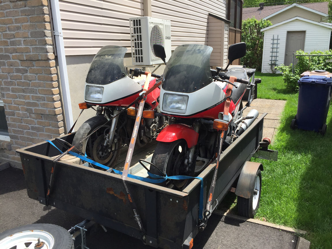

Hi, I have a friend who had 2 old FJ1100. He doesn't wanted to put money on those old motorcycles and he don't like to work on bikes. He know that I love to restore motorcycles, so he gave them to me. In 1992 I had a FJ1200 that was stolen. So I tough that it can be fun to use those 2 motorcycle to make a good one!

The first bike is now completely all apart. I had a real hard time to separate the exhausts and to remove the top engine mount bolt, the one with a 8mm and 10mm allen bolt. After the vacations, I'll do the other bike. Thats a project for next winter!
