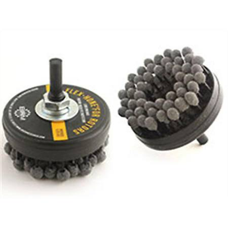

The oem FJ pads are organic...if you put on R-1 calipers and want to run organic pads fine, no problem.
However, if you want to change to sintered pads, you have to scrub off the old organic transfer layer on your rotors. (Both sides of the rotor) The organic/sintered layers are incompatible.
 If you don't, will your brakes work?  Yes, but not like they could...
Quick work with your cordless drill. Spin one way, light scrub, then spin the opposite way for a nice cross hatch.
The hardest part is flipping the rotors to get to the back side.
