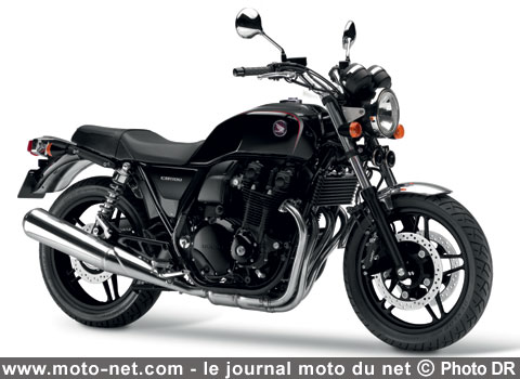

FYI since I really can't match the semi gloss finish of the engine and covers, I got some high gloss engine paint and primer. I intend to  paint the engine covers with the high gloss. Not OEM or stock looking, but a guy in the area has a Honda CB1100 with the side covers and valve covers painted high gloss and I really like the way that bike looks. It's an all black bike but they mixed semi gloss and high gloss.
