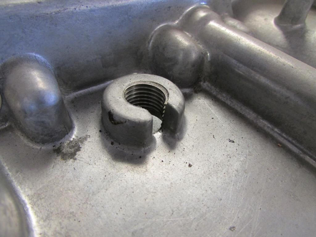

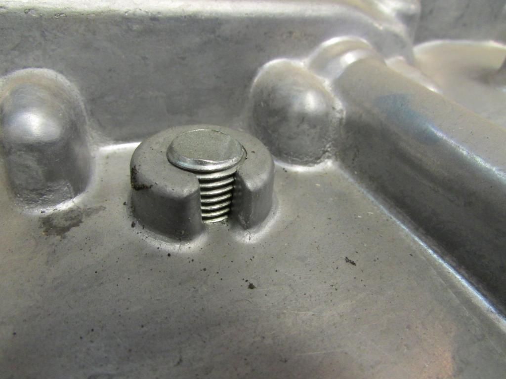

Quote from: jscgdunn on May 04, 2017, 10:11:30 AM
Randy,
Do you snip the coils off after installation?
Thanks,
Jeff
No, the spiral heli-coil allows the oil to drain through. I will snap a photo of the next one I heli-coil.
Don't let me forget...
Randy, if you don't cut the coils, what am I looking at in the picture?
A trimmed Time-Sert?
Quote from: Pat Conlon on May 04, 2017, 05:41:17 PM
A stock pan
Here is one with a the heli-coil installed.
I took one with a light showing through the gap in the heli-coil.
