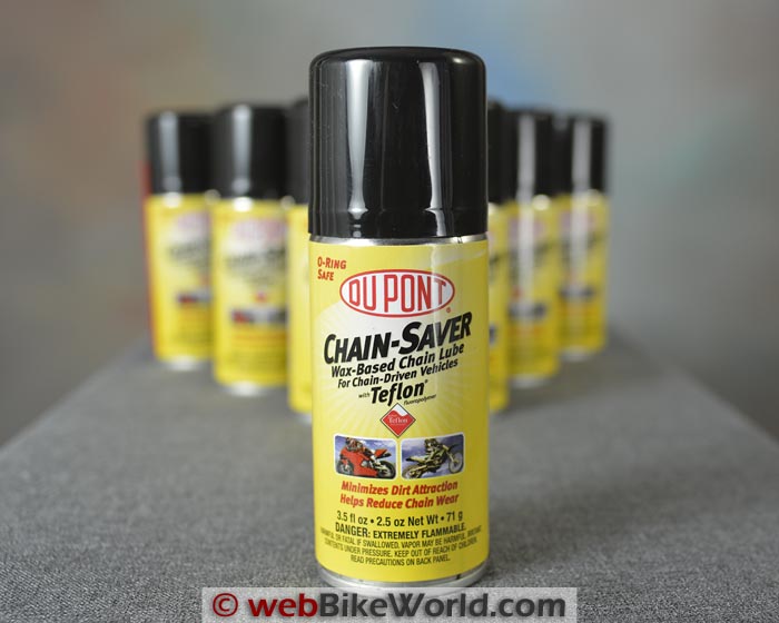

I mainly use the DuPont Chain Saver Teflon spray wax. The carrier solvents quickly evaporate and leave dry film. It works fairly well at not attracting dirt and grime. I usually carry the small size can of Tri-Flow in my tank bag for long rides. The DuPont Chain Saver spray is also readily available at most Walmarts.
To clean my chain, I use 100% Simple Green and a Grunge brush and water to rinse everything clean.
This chain was cleaned and lubed about 500 miles before the photo was taken and has about 15,000 miles on it.
