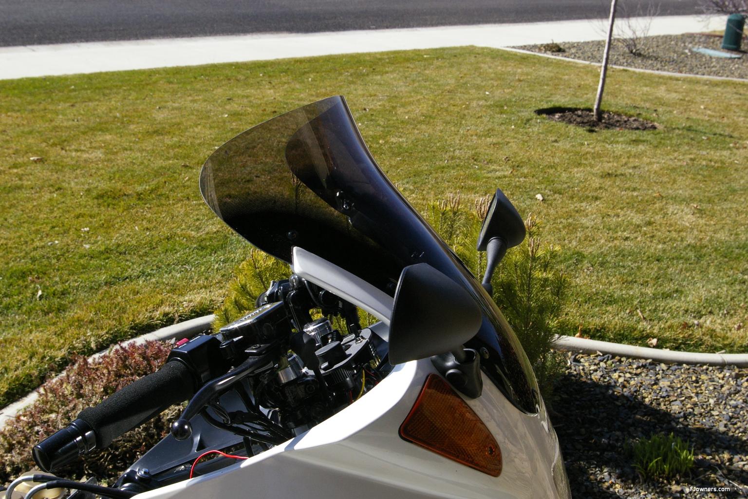

I can't believe nobody has mentioned the use of the MRA Touring Vario windscreen.  :pardon:
The adjustable flip shield works very well. I use mine during the cooler/cold months. With the adjustment at full up, the air hits at my helmet. Keeping all the cold air off of my torso. In the rain, the water is pushed down on my visor.
In the US. The MRA windscreens can be found at Twistedthrottle.com
A photo of Leon's 1991 with the MAR Vario screen
I am hesitant to say much about windscreens because of the variables involved.  On my 1990 I run a MRA Touring windscreen as Fred mentioned and love it but it might not be right for someone else. I am 6'-0, and long in the torso. At speeds I like to travel my helmet is in a dead air space, or at least no buffeting.  I do get some wind pressure on my chest witch is OK with me. The MRA Touring wind screen will put more pressure on the fairing uprights where the screen bolts on to.  More flexing at higher speeds.  That will be true with any taller windscreen.  I think the MRA is made in Germany and sometimes it takes a while to get one. Took me about 5 or 6 weeks from memory. Twisted Throttle can tell what the time line is they a good folks to deal with.
