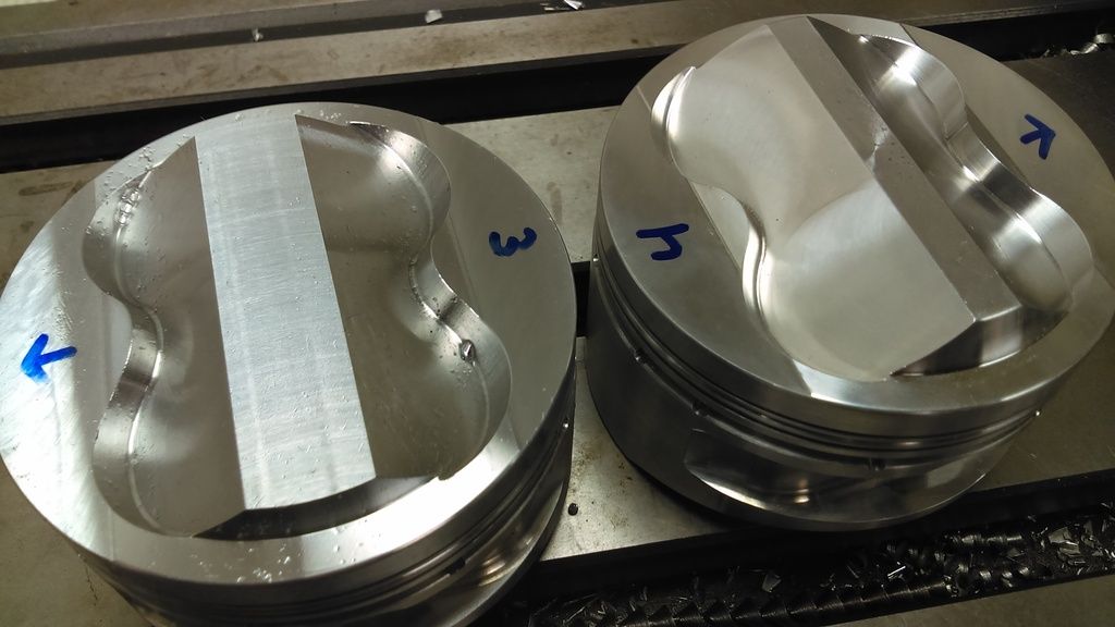

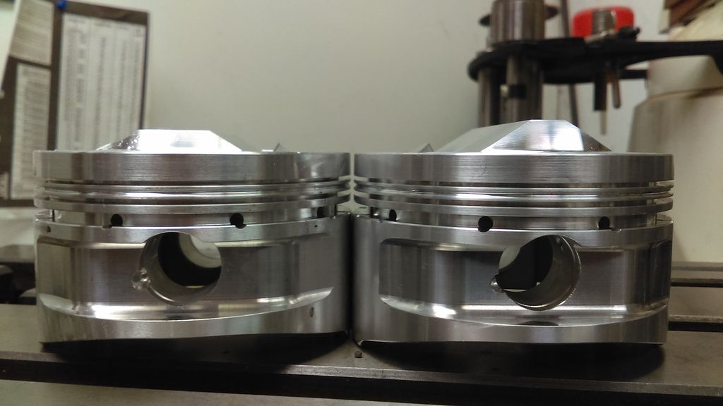

I decided to change direction. Those are the 83mm long skirt Ross pistons. Randy's cutting them down to get the compression down to ~10:1
The report I had on new oil ring design for the Hank Scott Pro Lite pistons was that it did reduce oil consumption, but was still using oil, 1 quart every 3k miles.
Ross won't make them with lower compression? I thought they would make pistons to your spec's. And why are you going to long skirts?
