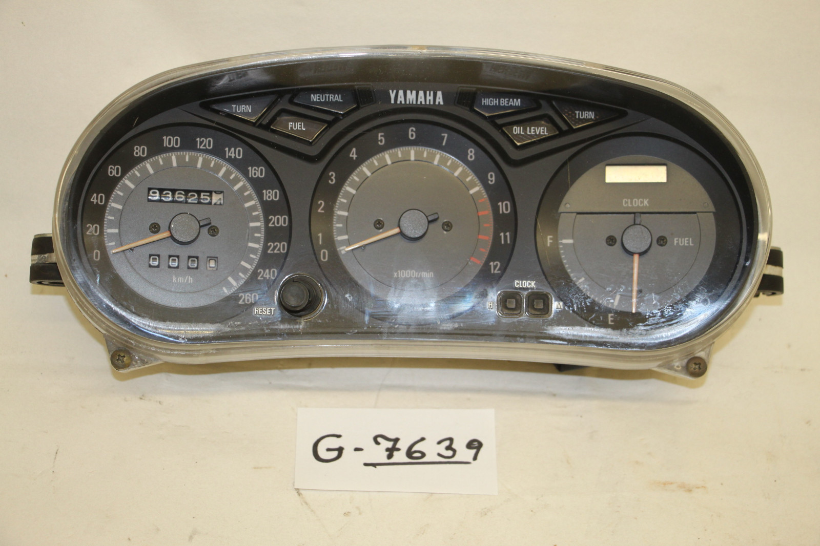

Ordered a new gauge "glass" though my local dealer. Ordered a kph cluster through ebay.de:
Canada is kph and staring at the speedo and straining to see the tiny little kph numbers on the inner ring was really getting annoying. I loose mph, but I don't really care about that because I'll never need it. I'll never have the bike outside Canada and if for some strange reason I do, I'm smart enough to do the math if I have to.
