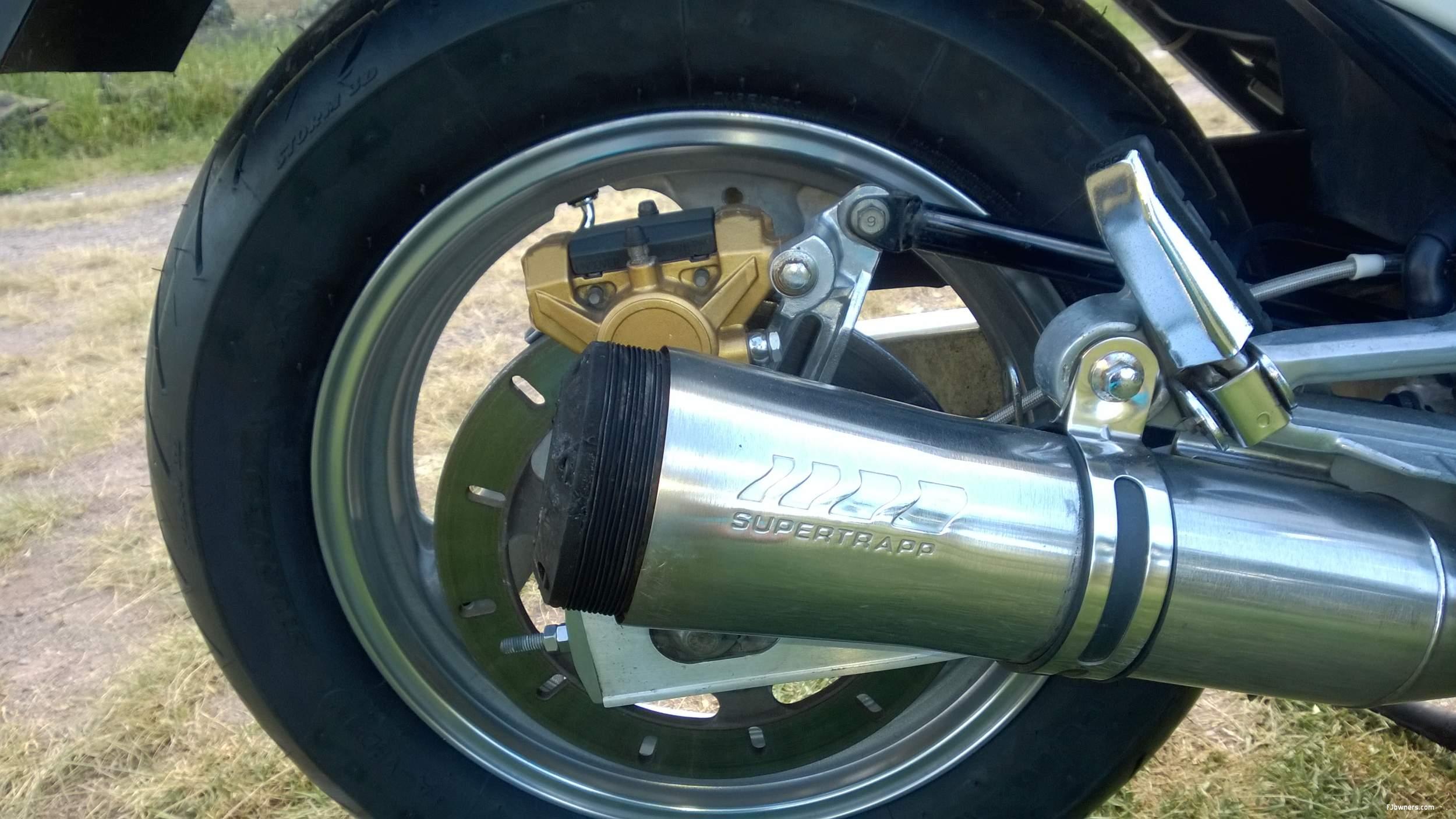

That style of strap appears to be universal....
Mine on a 89 with a Supertrapp
89 FJ 1200 Shiny Black
