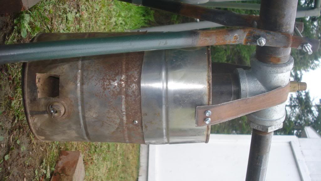

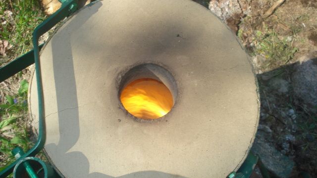

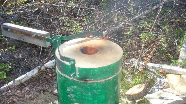

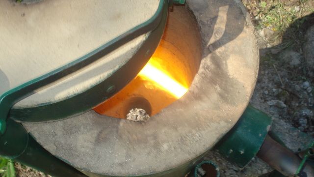

I made this furnace last year and pretty much finished it. I was planning on making
flintlock parts with it. It dosen't cost that much to make this setup. I found some
blue clay in a pit close by and lined the furnace with a mixture of silica sand and the
clay. Blue clay is a good refractory but not this blue clay. It won't reach the 2600
degrees f without turning to glass and melting.

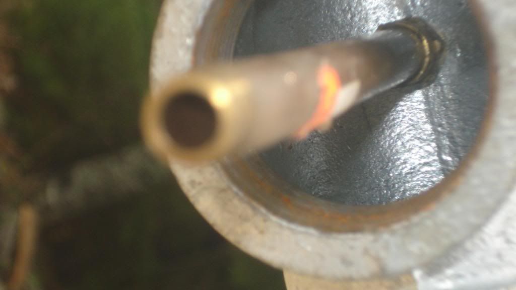

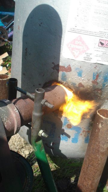

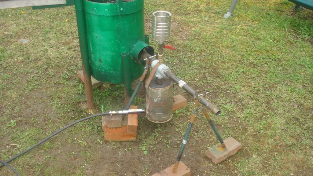

I made a waste oil burner called "The Brute" This thing will CRANK! It's freaky just
to light it up. I drip waste oil into a tube that is super heated with a propane torch
that I also made called "The Mako". I use a hair dryer as a blower.
To start it up, I heat the drip tube to cherry red. Turn the blower on low then ingnite the torch.
I can tell when the oil vapor is super heated. It actually changes color to a greenish vapor.
I made two furnaces, one is the melting and one is for lost wax burnout. They will both take
1900 deg f the way they are and that is plenty for aluminum. I think I can try my hand at making
some bike parts.
I need a crucible and the proper tongs which I can make. I need a few other things too like mold frames
I'll get this stuff together and maybe make some foot pegs and stuff like that.
Anybody doing any foundry? Theres a lot to it and a great subject if anybody's interested I mean. :sarcastic:

Joe, I love this stuff. Not so much what it does but how you made it and the fact you made it at all. I love the "can do' attitude.  Not a bought part to be seen. 100% scavenged and recycled parts.
That you scratch build you pistols is one thing but making your own furnace to cast the parts is something else.
I love this shot showing the leveraged, self levelling, insulated handled raising mechanism. Simple, home made and 100% effective.

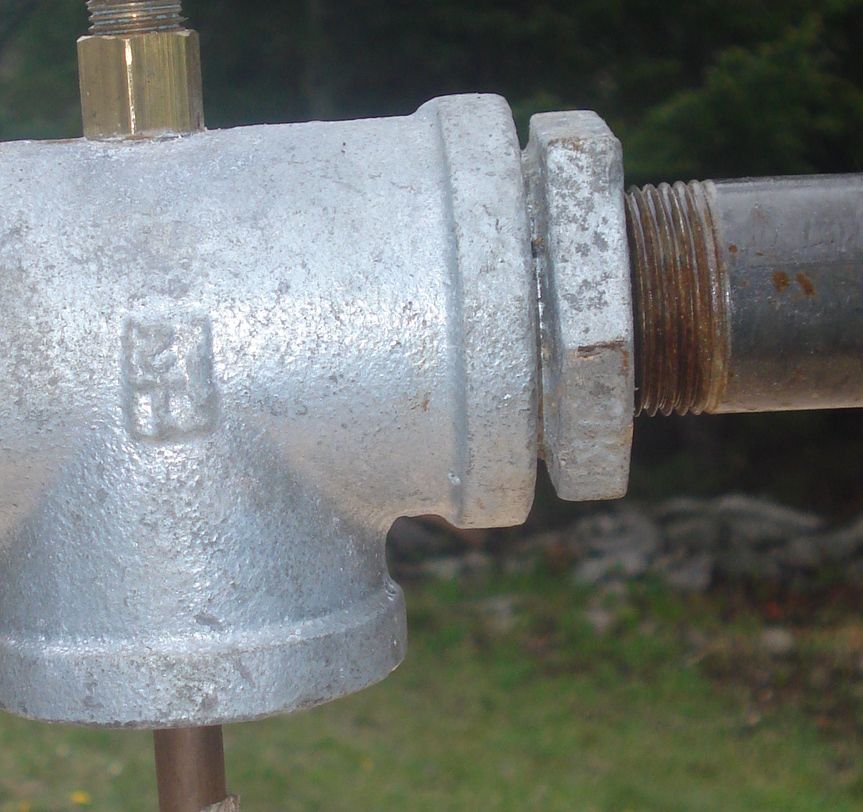

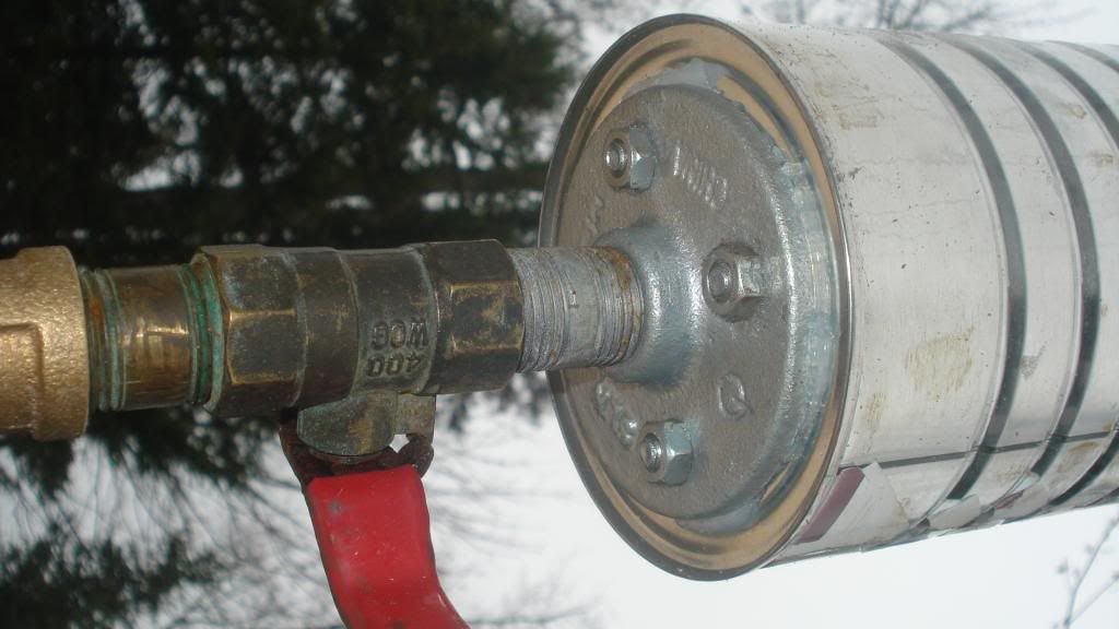

The brain in the brute waste oil torch is the oil dripper. A run up to the hardware store and get
some nipples and tees fittings and a valve.
This valve isn't good for this torch. As it heats up and the viscosity changes, more oil gets released
It burns rich and the carbon settles in the melt- and it smokes like hell!
I'll be changing this out for a needle valve in the spring.
The drip tube is just whacked off and  plugged, that's a sealed weld.
Stay tuned!

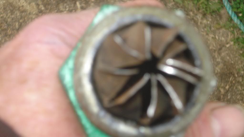

Turbulator; It needs one. It goes in front of the air feed tube and easy to make.
It just sits in the reducer. It's not anchored but snug.
Crappy pic. I used a piece of sheet metal the length of the circumference and cut with sheers.
bent to look good.

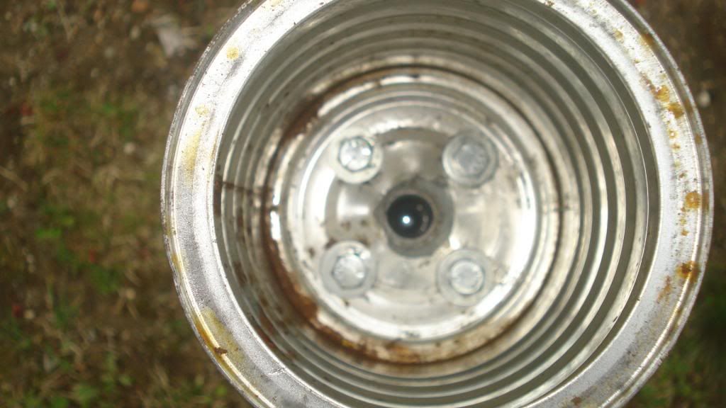

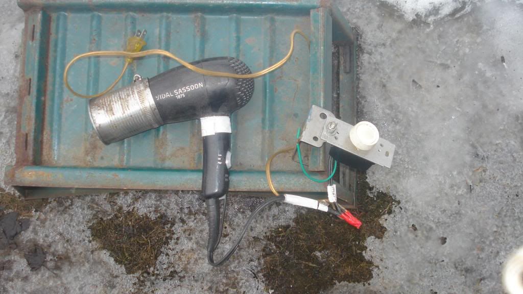

The blower is a hair dryer that rigged with a dimmer switch. It needs one cause you only need
5 cfm and less when you start the torch.
I use this rig for my forge too. You just stick in over the air in pipe and let it hang.

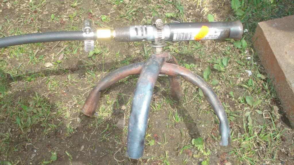

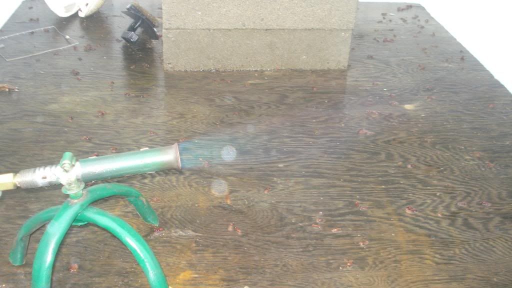

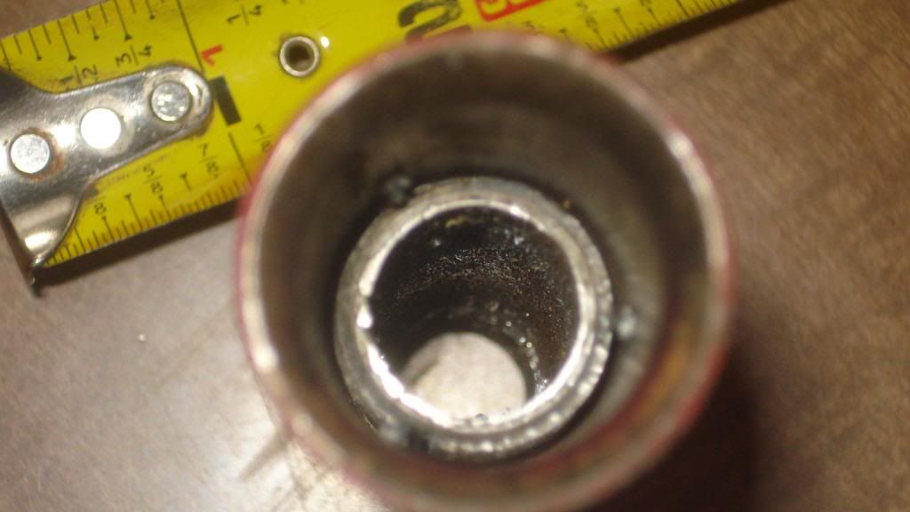

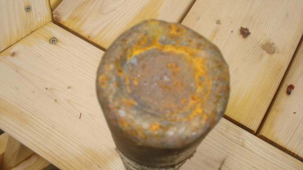

The propane Mako is actually intricate.
The slots have to be uniform and without burrs inside. Drill thru 1/4" on the side- theres
another drill thru 1" back from the end of the nipple. It's a 6" nipple. I had to add more
slots and a few more hole in back to get the right burn.
The orifice that delivers the gas is a .028 MIG tip turned inside and held with compression fittings
then screwed into a jag. Some sort of regulator would be nice too.
The pipe that's over the nipple is important. It has to be flared. I can't remember what I drove it onto
but it doesn't need that much flare to work. You need an air space between the inner and outer tube.
Drilled holes in the outer tube and set wire so that the outer tube can slide with some resistance and
yet maintain the uniform air space.
It's hard to see in this pic but I ended up adding 4 more slots to make slots 5 in top and 5 on bottom.
Drilled thru 1/4" again making 2 more holes on the sides. This torch has a duel purpose. It will heat
the burnout furnace to 1700 cleanly and it will superheat the drip tube.

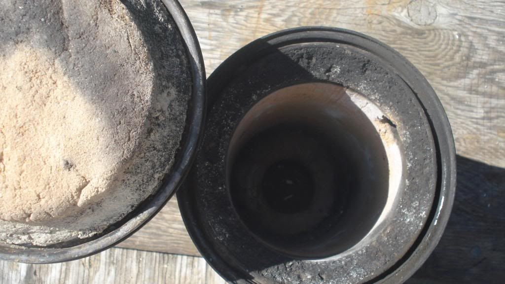

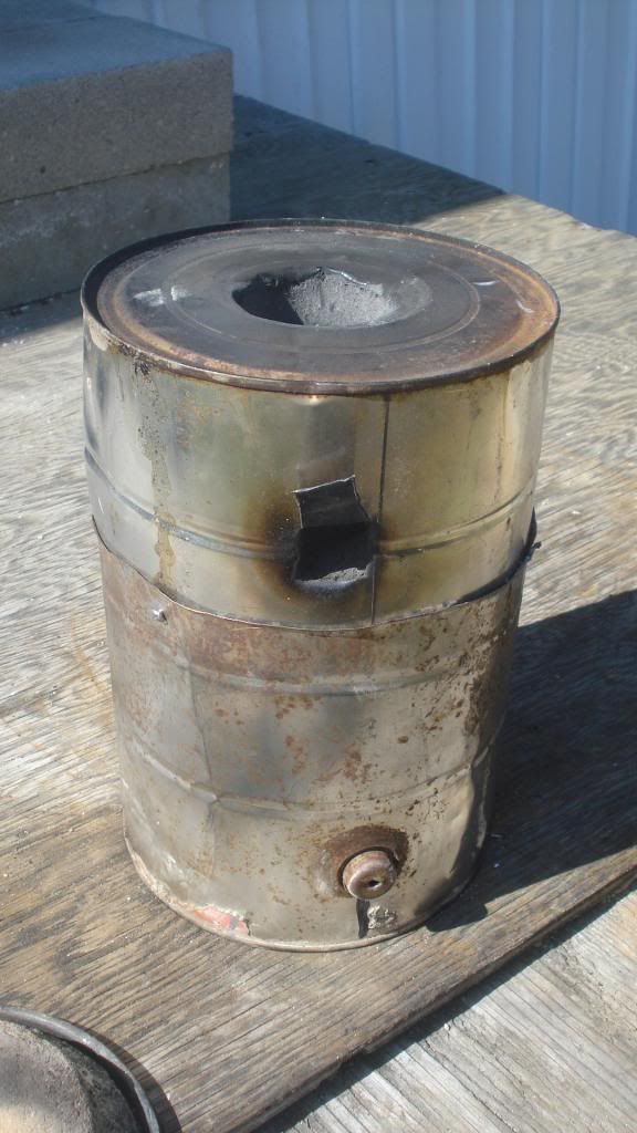

To heat the drip tube efficiently, I needed to make it's own little furnace. Hold the heat in and
turn the burner down low. I found 2 paint cans. One, I cut the top off and the other, I cut the bottom off.
I slipped one inside the other and made one tall can. Formed the vents and inside then potted the
clay mix in. I also potted the cover. Theres wire attached to the lid so the clay will stay put.
Then I fired it.
Screwed the lid down with self tappers and made a strap to hole it up around the drip tube.
