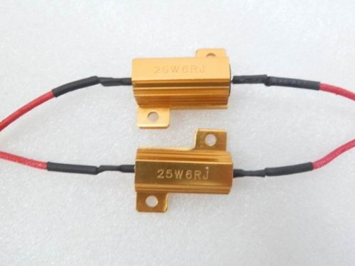

One thing to note about Randy's tail light kit, is that it doesn't come with any resistors.  This is only an issue if you want to retain the OEM flash rate and/or the self canceling function.
If you do decide to install resistors, I would recommend avoiding resistors of this type of design:
In my case, one of the resistors in the pack I bought, had a broke wire inside the black (shrink wrapped) section.  The local shop that I purchased them from, had a replacement pack, but here in lies the warning. The replacement pack also had a resistor with a broken wire in it.  they gave me the good resistor out of that pack and I ended up reinforcing those sections of wire by using a small nail and shrink tubing as a splint.
Eventually I installed Rizoma rear turn signals to work along side the integrated turn signals and they came with these type of resistors:
This made the original resistors redundant and allowed me to remove them.  The nice thing about this type, is that you don't have to hack up your wiring harness.  Also, though the above are the ones that come in Rizoma's kits, similar ones are available from various sources.
