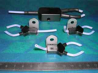

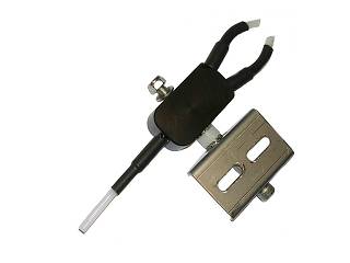

I too have a modified Hawke Oiler on my '92 and it works great.
I use the Pro Oiler tip which oils both sides of the rear sprocket:
Rather than a automatic feed (I don't trust) I installed a momentary contact button in my left switch cluster. On long trips, I just have to remember to give it 5 shots when exiting the freeway off ramp when stopping for gas....about every 190 miles or so... Works well.
Oiling via the sprocket, works best at 20-30 mph.
