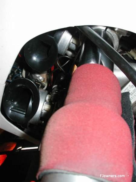

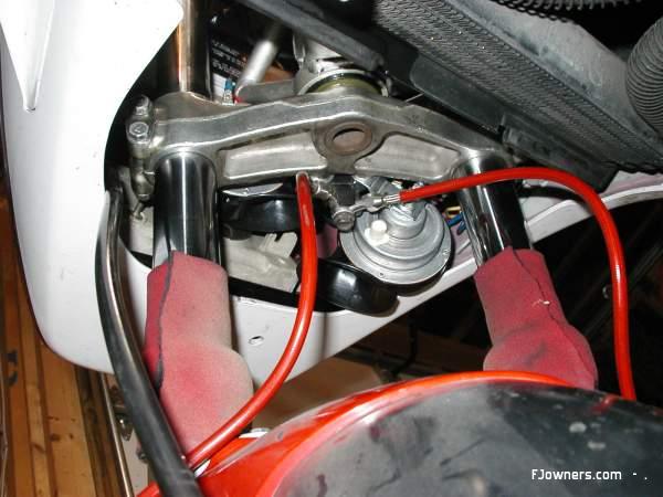

Mr. Bean, please post a pic or 2 of your horn installation. I tried for several hours to cram this thing into the steering head area, and I I ended up with was cut knuckles.  Not love nor money was getting that thing under my fairing.

I used the FIAMM Freeway blasters, one Hi and one Lo tone each, on both the FJ and the FJR.  Much easier fit on the FJR, more room and it already had two horns from the factory.  I got the horns to fit under the fairing on the FJ.  Had to shorten one bracket.  Its tight and not much room before a mis-positioning starts hitting.  And you have to move them out of the way to change the headlight bulb.
But they rock as far as decibels.  Cagers heads snap around when they hear it, as they start changing lanes without signaling or looking.
