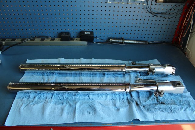

I rebuilt a set of 84 forks this weekend. I wanted to offer some photos and dimensions of the reduced diameter between the triple trees.
The reduced diameter is 39mm and it varies from the top of the tube the two I had this weekend was around 73mm from the top. The reduction appears to be done by sanding, not machining so it is inconsistent in the depth from the top of the fork.
I am not sure when they stopped doing this reduction, but I do know the 89+ do not have this and are the same length.
