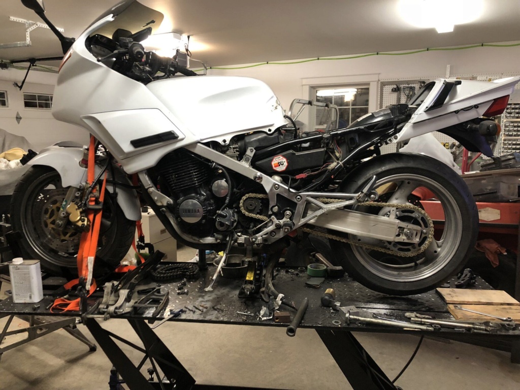

I have the FZ1 swing arm installed on my 95 FJ. You can see the added space between the front of the wheel and the inner fender.

I live in Kansas, 90% of my riding is done an straight roads. The hard luggage is also mounted. Yes, I went with the longer FZ1 swing arm for a bit more stability when the bike is loaded

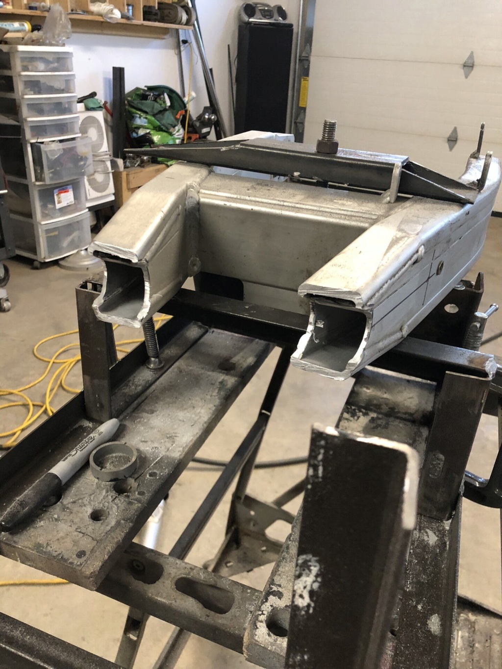

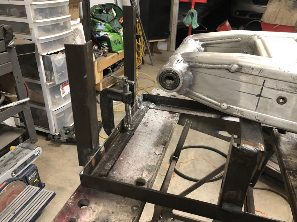

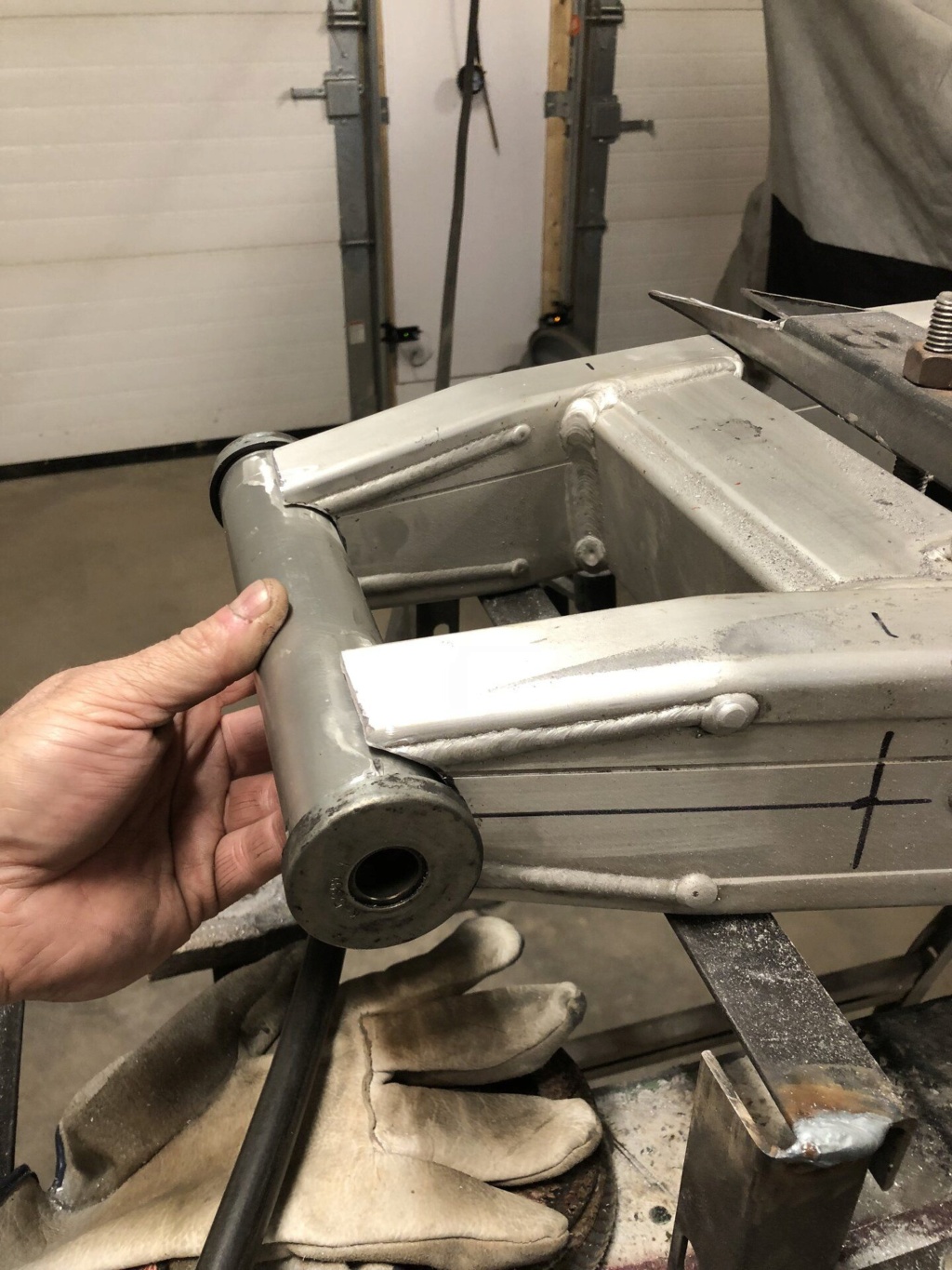

I put an fz1 arm on mine, but I cut it down to FJ length:
FJ arm on top, FZ1 on bottom. I lined them up at the shock/linkage mount and then cut the pivot tube back so I could maintain FJ linkage geometry. I just accepted a few fractions of an inch longer at the rear rather than cut and remount hte axle adjusters/mount.
I'll admit that's a little bit extreme for most guys, but having the rear wheel so far back would have driven my OCD nuts! not to mention, the FJ has luxury liner style handling as it is. Making the wheelbase even longer would have slowed it down more and that's not my type of riding. I've got a VMax engined Yamaha Venture for putting on the miles....;)

great white
Kinda depends on what part of the geometry you want to maintain.
When I did the swingarm, I wanted to maintain the shock linkage geometry. Altering that changes quite a few things. Turns out it was the linkage mount to pivot length I had to maintain.
You'd have to make similar decisions depending on which arm you use. The thunderace may be a similar length as the FJ arm, but its a matter of what measurements you want to keep and which you are comfortable moving away from stock with...
