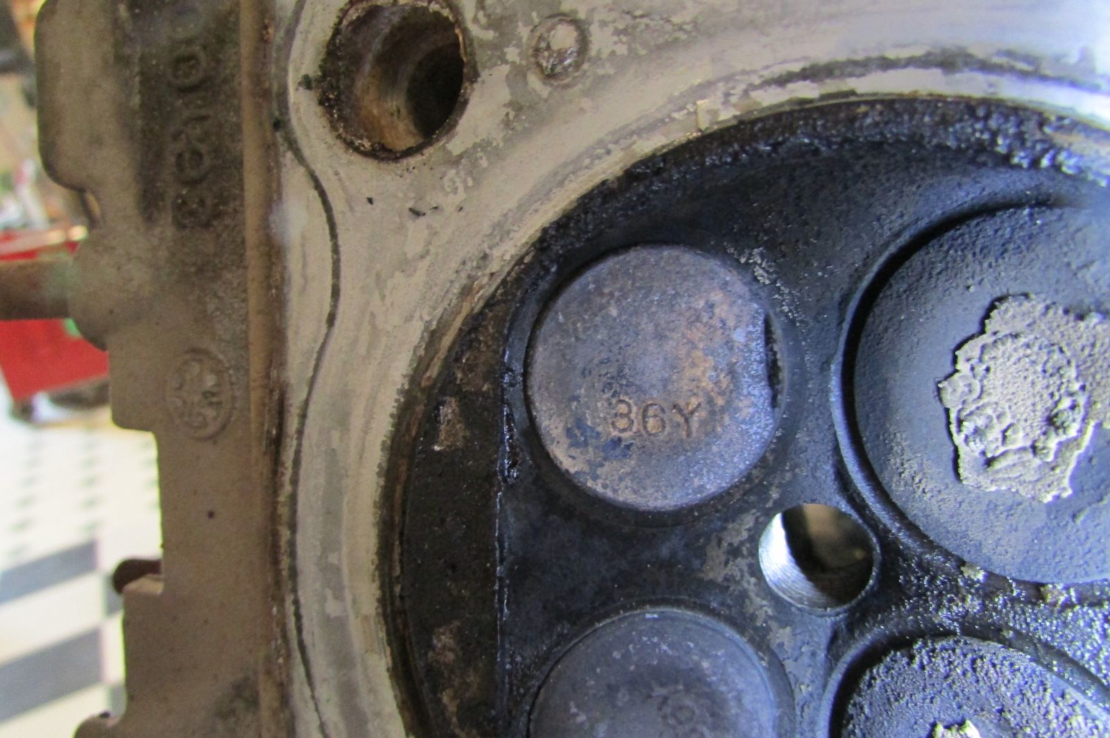

Started by removing and taking measurement of all the shims in those positions that were out of spec.
After a bunch of math, I figured out what shims were needed, and what shims I had to work with. :mail1:
I also figured out that taking measurements in inches, then converting them to metric, and back again was a waste of time. My feeler gauges have both readings on them, so at this point I decided to just stick to metric measurements.
I moved around the shims that I could move, and checked my own stash of shims for spares that I could use. (turns out I only had one that was useful)
Did the recalculating, and it turns out that it needed exactly 2 shims that I didn't have.
