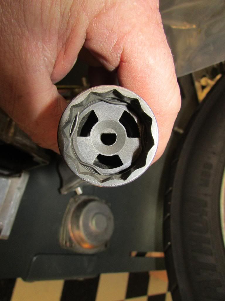

He's not...
You have gotten the adjusting "D" shaped rod wedged into one of the outer oil flow holes.
You have to center the rod when inserting and make sure it is clocked with the "D" shaped hole in the center and it will slide right in.

Yes, look at the picture I posted earlier.

That last inch is the range the "D" shaped rod contacts the damper rod at the bottom and you used a hammer to install it.
It will slide right in without any force when properly installed.
