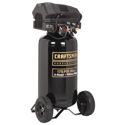

I've got a bit of first hand knowledge on this topic.  I bought my house a dozen years ago mostly for the garage...I immediately set it up as a shop with compressed air plumbed to three locations.  My first concern was the noise level.  I would be locating the compressor outside in a three-sided stucco enclosure.  This would baffle most of the noise in three directions and send the remaining noise towards the mountain.  I've heard my share of compressors that were ear-splitting and I didn't want to be "THAT" neighbor!!  I bought the quietest compressor I could find that fit my needs:
It's a Craftsman Professional 25-gallon upright, 2-stage oil-less.  In it's size and price class (around $400), it was the quietest at around 75db.  It's performed flawlessly for a dozen years and not a single complaint from the neighbors.
I don't see mine offered at Sears any longer.  I see they now have a "Super quiet" 27-gallon model on sale for around $450 that is rated at 73db:
http://www.sears.com/craftsman-professional-27-gallon-vertical-portable-air-compressor/p-00916474000P?prdNo=1&blockNo=1&blockType=G1
Their standard, "non-professional" "quiet" compressors rate around 78db.
