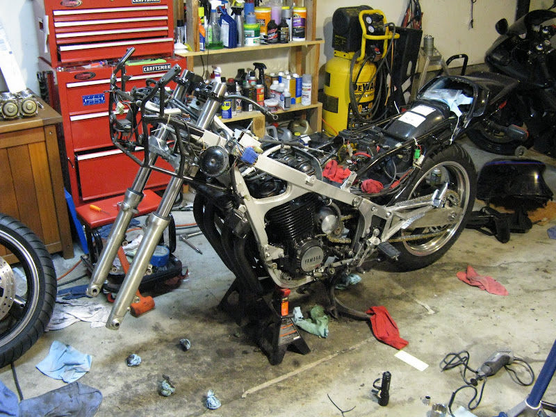

i have been looking for a sport tourer and i came across her in sept. decided to make it a winter project. initially i had envisioned this wonderfull fully rebuilt bike, but that fell apart when i realized painting and a few other bits would be too costly for me right now and all i wanted WAS TO RIDE!
so i decided to focus on what it would take to make it reliable, safe and fun. i bought it for $1600. she would start, but not rev. as soon as you touched the throttle it would die. also, the forks were leaking badly and the tires were very old. Last registration was 2009 so it sat for quite some time. mileage was 19k. some parts looked like they aged very well, others, such as the grips made me think maybe it actually had 119k. but how do i really find out right?

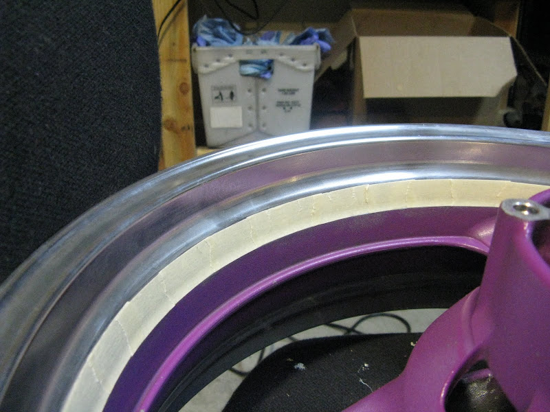

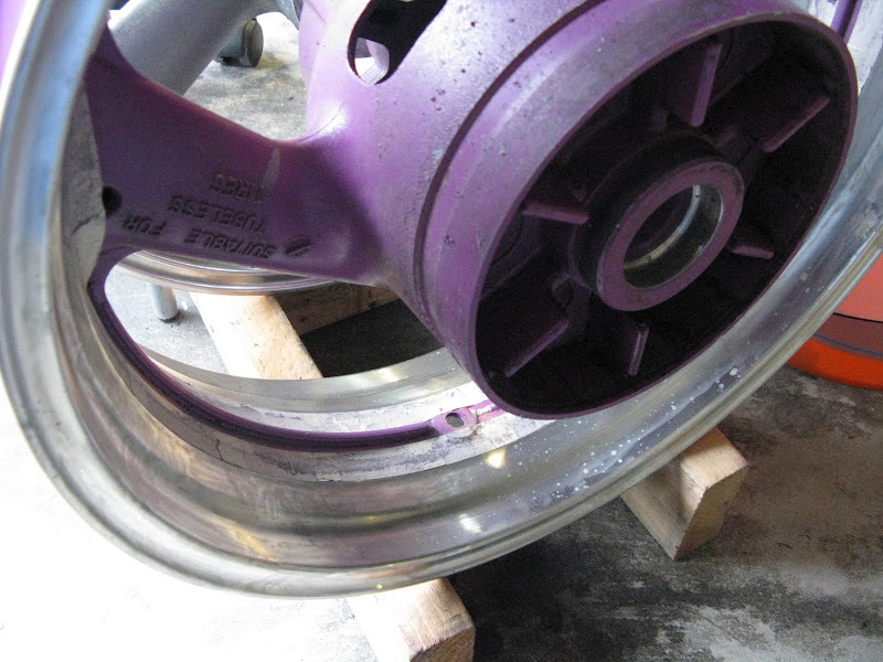

I managed to get a free yzf wheel that literally fell on my lap! but i was purple. i cant tell you how many hours, no, days worth of effort it took to polish the wheels!
Randy supplied me with the fork rebuild kit and all the carb parts to completely overhaul them and rejet it for my V&H 4-1 (which i got on ebay and was pretty beat up, i'll polish it and clean it up some other time).
I bought the best chain i could find and proceeded to get to work. i totally screwed up on the stem bearings, and ended up messing up the lower bearing on the fork bit. i should have taken it to a shop to have pressed in, but ended up hitting it with a brass drift and walking it around till it got in. but i badly messed up the cage in doing so. i tried to straighten it out and hoped that when it all got put together =. my first ride it was too lose and you could see it shifting, but once i tightened it up. all was well.
i went with sonic 1kg springs, but since funds were low , i didn't "spring" for the emulators, lol.
i synced the carbs as best i could, never having done it. and used the colortune for the mixture. BUT, i literally have gotten 100miles to 4 gallons, WTF?!? SOMEONE HELP ME
