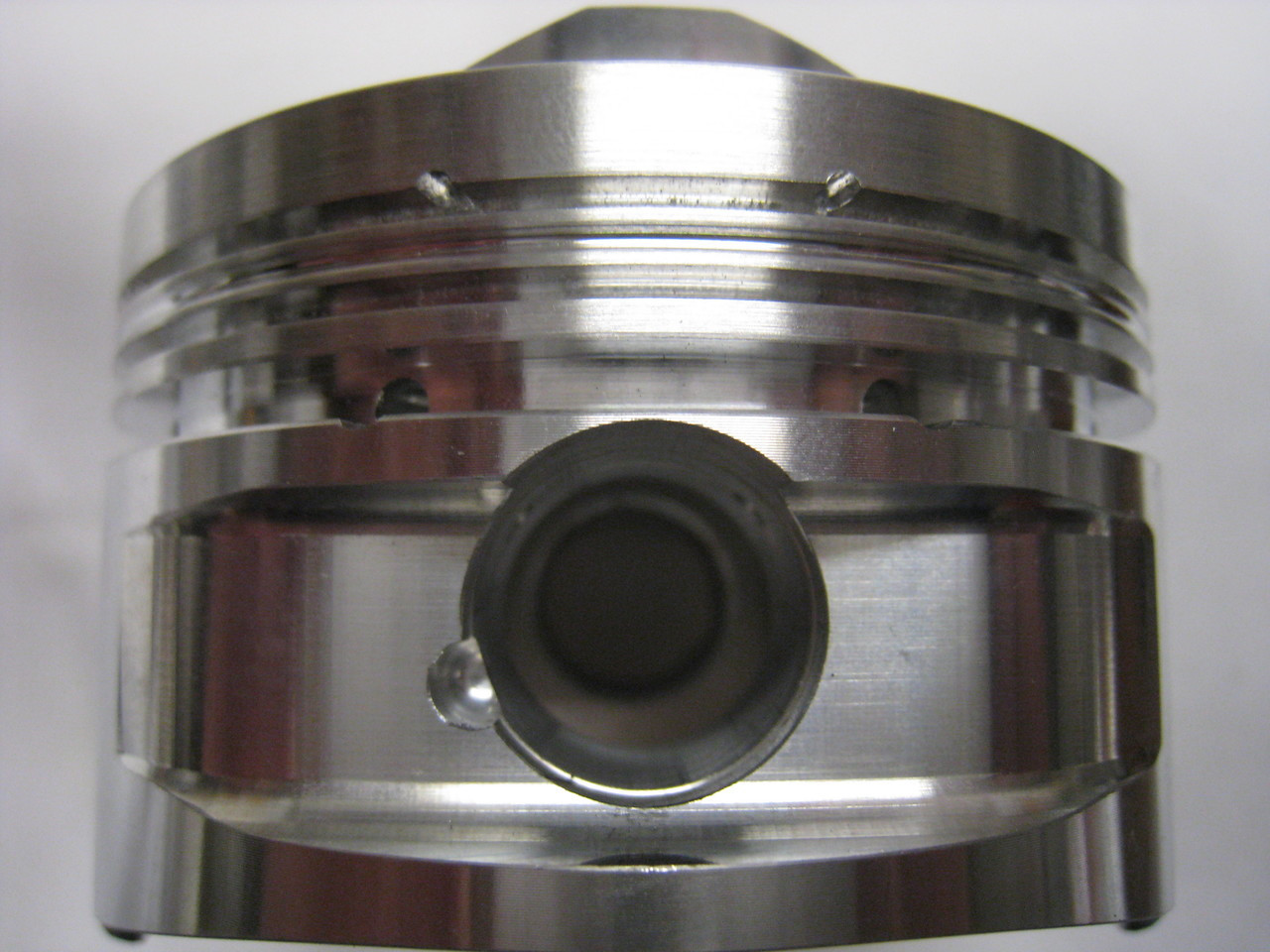

When you do decide to go with the big engine, stay the fuck away from those short skirt Wiseco pistons....don't get me started...
Cheers. Pat
Which pistons and big bore kit do you recommend Pat ?
I'm thinking of going down a very similar route to you, engine-wise, with a project 1990 FJ that I bought earlier this year.
The short skirt Wisecos proved unstable, the oil rings did not seal.
The regular skirt Ross pistons are rock stable and better for the street.
The poor oil seal with the Wiseco's wasn't  due to the rings, both Ross and Wiseco used the same XC ring packs. I suspect it was the rocking of the short skirt piston in the long stroke of the FJ that was the culprit
As you see by the kits below, they are 12 : 1 compression...I didn't want that high of compression for an air cooled street engine running on Calif piss water 91 octane gas, ridden in the desert summer heat, so RPM Randy took the Ross pistons and shaved the crowns down to get a more forgivable 10.5 : 1 compression. Turned out to be a Good Move.
