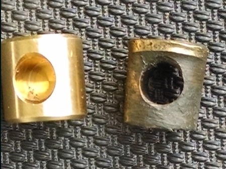

Motofun,
The FJR clutch handle has a brass bushing inside that pushes the clutch rod into the master cylinder.  These things wear out, but it's a cheap fix.
Index #4, click this link for FICHE:
#4 clutch rod bushing
PIX:
