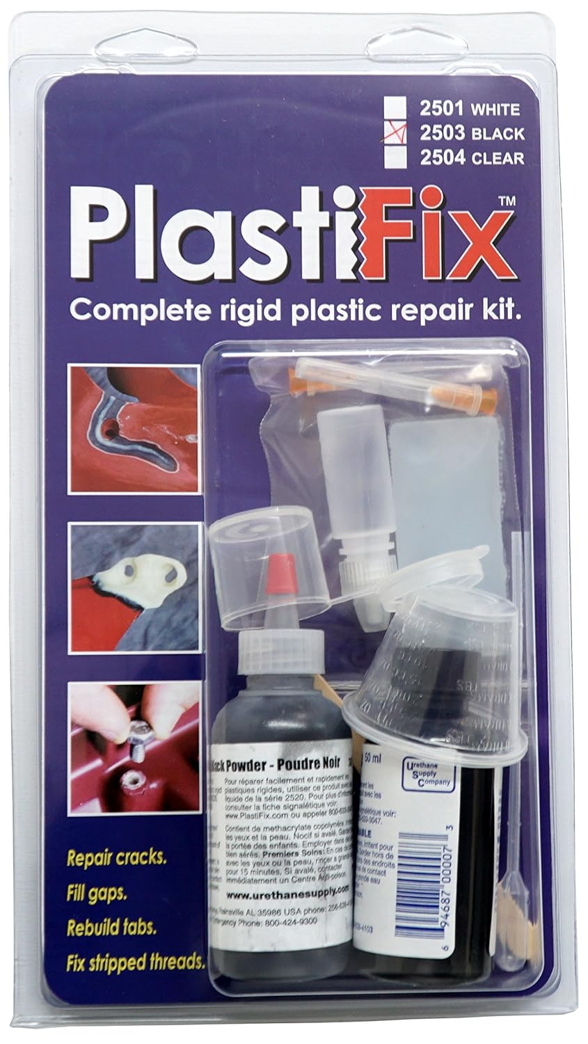

ZOANOM just showed me this past Friday his reconstructed front fender tabs.  He used a plastic repair product but I can't find it with Google.  Maybe he'll chime in.

I have not personally used this product. I have seen posts here on the forum along with photos of the repairs. This seems to be the ticket for fender and fairing tab repairs.
https://www.plastex.net/

Plastifix. Ignore all other suggestions. It is a very simple process, and the result is stronger than the factory plastic. My tabs cracked multiple times with other methods. I just used the cracked off piece to mold a new tab for each side.
