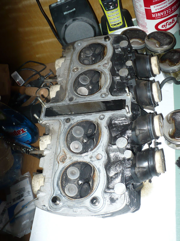

Asking the collected wisdom......  does this head look ok?  The far (#1) cylinder looks different than the rest on the exhaust side.  First time deep into an engine other than a Briggs and Scrapiron, so any info would be great.
Also, what about this piston... the deposits are kinda 'bubbly'

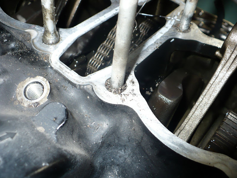

And this is what happened to my cylinder studs..... sigh

Looks like she was burning oil in that cylinder, probably a marginal valve seal and oil seeping thru when she was on the side stand....
Don't know about the studs.

Everything looks about normal on the head/piston is the area of carbon. The difference could also be due to carb adjustments.
The valve stem seals should be replaced while you have the head off, and I stock a better positive stem seal that will outlast the stock seals.
As far as the studs, the rubber that has deteriorated was there for decoration/protection of the stud. Take it off and paint the studs and put it back together.

Thanks for the info, took a look at the price of those studs, a little on the dear side.

Don't worry about rubber sleeves, my expert advice when rebuilding was not to replace them. 32,000 km's later I can't argue!

The rubber sleeves on the studs are just noise dampers. Cut off any that are left and don't worry about it.
