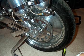

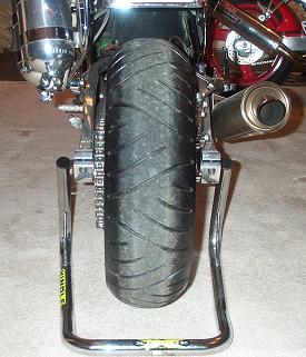

The next modification I did was the 5.5” rear wheel conversion.  I purchased a Performance Machine “solid” (dish-style) from California.  Cost:  $1100 Canadian.  There wasn’t too much work involved with this mod.  I did not have to machine the wheel spacers, or anything.  I put the sprocket on from Sprocket Specialties that came with it, and the wheel bolted right in using the stock axle.  I removed my old chainguard (which hit the tire), and had a custom aluminum model made for me by a friend which I had powdercoated red.  The caliper torque arm, on the other side had to be modified.  All I did was remove it from the clevice which secures it at either end, and merely move it to the outside of each clevice.  I installed a small, thick washer-like spacer where it used to sit, and installed longer bolts.  Voila.
I at first tried using a 180-sized rear tire, but found that it rubbed against my chain.  I ended up settling for a 170, and have used that size ever since.  The PM wheel is direct-drive; that is to say there is no cush drive hub, and the sprocket bolts directly to a raised portion of the rim.  You do notice a slight difference when you drop the bike into gear from a stop at intersections, but other than that, I couldn’t feel anything different between shifts.
As for sprockets, I use a Sunstar 16-tooth at the front.  I always have, and found you can really beat the hell out of them and they really stand up.  The rear sprocket I ordered was a Renthal aluminum 47-tooth.  It lasted about a month after I put the nitrous oxide on, and then looked like it was made out of chocolate.  I switched to a Sprocket Specialties 49-tooth “titan-tough” model, and experienced no further problems.  With a 16/49 combo, the bike’s top speed dropped to 140 mph, but it gets there in a hell of a hurry.

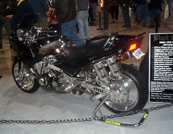

And now for my favorite part of all:  nitrous oxide.  I must say, the only experience I had prior to installing it on my bike, is from Mad Max movies.  I had already decided, at the beginning of my second season with the bike, that I was going to do the motor up.  However, I wanted to put the nitrous on, and had at least an idea of what it would do to the motor, so my logic was this:  might as well put it on a stock motor, blow it up, and rebuild it the way I want anyways, rather than ruin a freshly-rebuilt motor (and have to rebuild twice).
The basic kit for a bike is around $1000 Canadian.  You get everything you need, and the kit is a one-hit.  When you push the button, you get all the power at once.  There is not a progressive controller that only lets out so much at varying RPM’s.  Those controllers are still around $600 still, and I now add about 80 horsepower to the rear wheel, and can use it as I go into second gear.  I can control the bike without the progressive unit, so why bother?
The basic operation of the motorcycle nitrous oxide kit (the way mine is hooked up, anyways), is like this:  1) Turn the tap on the bottle to full-open.  2) Turn on the switch in the dash (I located mine in the coin holder) to send power to the in-line mercury switch at the carbs (solenoids) & secondary fuel-pump 3) Go full-throttle – there is a mercury switch activated by the throttle arm on the carbs that will not permit the system to activate unless the throttle is wide open.  The premise here is that it assumes the crank is spinning as fast as possible.  4) Hit the horn button (the actual horn is disengaged at the same time).  As long as you hold the horn button down, and are wide open, you keep on the juice.
Remember when I mentioned about all of the room created by removing the airbox?  What a perfect place for the fuel & nitrous solenoids, lines, electronics, and extra fuel pump!  Everything tucks away quite neatly.  The kit recommends installing the nitrous/fuel fogger nozzles by drilling holes into the carb intake boots (between the carbs and the cylinder head), and inserting the nozzles into the holes, and sealing them up with some goop you get with the kit.  This works for about one season, and then the intake boots begin to crack.  If you have ever priced out replacement intake boots, you will find this installation method unacceptable.  Fortunately, for about $300, APE sells “manifold plates” – ½” thick anodized blue plates that mount between the intake boots & cylinder head (you will need to supply the longer bolts), made directly for FJ1200 cylinder heads.  The fogger nozzles thread directly into them.  This adaptation will not work with
 an airbox, as the carbs must be moved back ½”.  It is very trick, and works exceptionally well.    ------------------------>

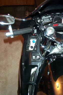

                     Nitrous & Purge Switch
I would also recommend a purge kit, which will get air out of the system prior to it’s use (and no costly backfires, and more importantly, FIRES).  This kit runs you about $300 again.  I did have a slightly explosive backfire once prior to having this kit, and I had to rebuild my carbs because of fire damage, so I know it does happen.

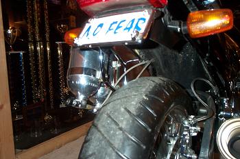

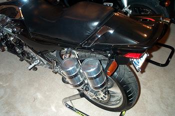

I was not happy with the bottle mounting method, and ended up with a setup as is on the bike today.  First of all, buy a second bottle bracket.
With only one, the bottle flops around too much, and the siphon tube inside constantly breaks from the vibration.  Remove the siphon tube, go to the end of your driveway, and throw it as far as you can.  Mounting the bottle upside-down, and angled backward works best (and is also a possible method mentioned in the kit).  Also, as you increase the jet sizes in the fogger nozzles, you use more and more nitrous.  I only get three 9-second (approximate) hits out of a bottle, so I installed two.
Use:  I used the smallest kit, which added about 26 horsepower to the rear wheel, and started off by hitting the button in 5th gear, at around 100-odd km/h.  The sensation was merely like changing gears. Eventually, I got used to it, and upped the jet sizes in the fogger nozzles, and began to use it earlier.  Using nitrous is not as is depicted on “Biker Boyz” or “The Fast & The Furious”, or any movies, for that matter.  You will not be able to jump over bridges that are out.  It is very controllable, and the FJ does not behave badly or squirrelly.  I settled on my bike making just over 150 horsepower at the rear wheel, on the gas.  It was enough that when I hit the button in the lower gears, I would be jerked backwards.  I also removed the ignition advancer, as you can’t use it with nitrous setups.
Shortly thereafter, I had my seat re-upholstered to resemble more of a solo cap, as I kept sliding backwards.
Many things happened during the season of nitrous oxide use.  My motor did not explode, like the rumours say.  Not exactly.
I burned a hole in my number one piston.  I burned up my valves.  Badly.  Worse still, I stripped out the threads of my axle-adjusters on the swingarm, and managed to slightly twist my sub-frame.  I stretched my stock chain to its’ limit.  Here is where installing a nitrous oxide kit gets expensive.

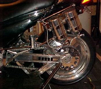

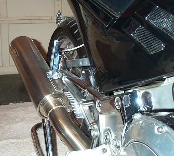

First, we should discuss my absolute most favorite modification to the bike:  the rear swingarm.
I am an avid reader of Streetfighters Magazine.  It caters to individuals with my tastes.  I happened across the JMC advertisement, and their prices were not too bad, even with the UK-Canada exchange and shipping costs.  What sold me on JMC, however, was their customer service.  They returned all of my phone calls (despite the time zone difference), and even gave me a courtesy call after I took delivery to make sure I had no concerns or issues with the fitment.

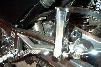

 I requested a swingarm with a permanent 4” extension. Looking back, I should have asked for 6”, because the front end can still be lofted under some circumstances.  I fell in love with the eccentric adjusters that were on my Dad’s ZX-11, and asked for those to be installed.  I wanted the swingarm to be top & bottom braced (more for looks rather than rigidity), and finally, mirror-polished.  The final price was around $1200 Canadian, once I got it.

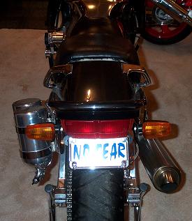

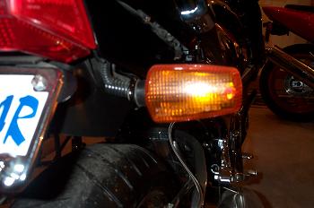

Shortened signal

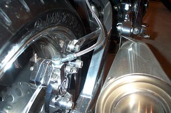

I cut the rear fender of the bike to make room for the wheel, which  was now back further.  While I was at it, I flipped the bracket that holds the license plate on upside-down.  This gives the plate a more rakish angle.  I re-used the stock signals, but shortened the stalks and hid the extra wiring. I tried previously using the small Lockhart-Philips turn signals, but the bulbs burn out frequently, due to vibration and heat buildup.
The thing simply bolted right in.  No machining, nothing.  It came with its’ own axle, and everything went together like it was meant to be there.  JMC even relocated the swingarm portion of the bracket for the torque arm (thereby retaining the same distance) so that it could be re-used.  Grease fittings were included, so I didn’t have to do any major removal, etc, to keep the bushings lubricated.  I no longer had a use for my chain guard, so it was removed, and I went with a Tsubaki Sigma 530 chain.  It is an o-ring chain, and Tsubaki makes a 125-link chain that wil accommodate the extra length and sprocket combination I have (after that, custom chains were required that increased the price).  I believe I have around 123 links.
The biggest issue with the swingarm mod was the shock.  I doubt there would have been a problem if the stock length was retained, but because the rear tire was moved backward, the ass end of the bike had to be lifted.  I tried many different taller shocks (and doggy bones to match, of which I fabricated many), and found that the VFR750 shock off a single-sider worked best.  It took a bit of grinding and the fabricating of spacers for up top to get it to fit, but it worked.  This lasted for a couple of years, and then the shock blew.  I don’t know if it was because I carried the extra weight of a passenger, or what.  I solved this by removing the spring, and replacing it with a solid aluminum collar, turning the bike into a true dragbike hardtail.<SOLID SHOCK 1.JPG>  Advantage:  all of the power is immediately transferred to the rear wheel.  Disadvantage:  you fly off the seat if you hit a bad bump.  There was not a comfort issue here, however; I put in several 800-km days with the bike like this, and had no complaints.  It is still holding up. It may also be due to the fact that I used Class 9 steel bolts at the doggybones, and top clevice.  Make sure your measurements are correct – they have to be, because now you can’t compress the rear-end to make the shock fit.

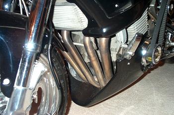

Of course, I had to get rid of that stupid Vance & Hines piece of garbage pipe.  I did a great deal of shopping around, and decided on Supertrapp.  In the motorcycling community (at least here in Ontario), Supertrapp is generally laughed at or frowned upon in motorcycling circles.  It is more a pipe you should be putting on your 5-litre Mustang.  However, it satisfied these criteria, which were very important to me:  1) Drain plug access is retained.  2) The pipe is brushed stainless steel, from front to back (not just a stainless header pipe or something). 3) It bolts up to the existing location at the passenger footpeg.  It is a very attractive pipe.  I added extra discs (14) total.  By doing this modification, I removed the flatspot created by the Vance & Hines pipe, and added a total of 6 horsepower to my midrange.  I could feel the difference while accelerating through the gears.  The total cost for this was about $1200 Canadian.  The problem is, Supertrapp has now stopped making this pipe for FJ’s.

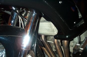

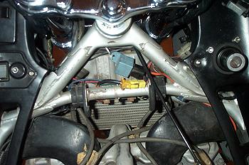

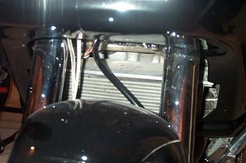

I removed the stock oil cooler and purchased an Earl’s model, based on the advice given to me by Clint Komenda, a long-time member of the FJ list, who also has an ’88, which makes a ton of horsepower.  The new cooler from Earl’s is about twice as thick, and 1½ times taller, and the same width, as the stock unit.  It has bolt holes at either end through small brackets (which look like flaps) that you can use for mounting.  I made a thin rectangular base plate for the bottom, with two small “L” brackets that could use the stock mounting holes on the frame.  I slotted the holes on the L-brackets so that they could pivot.  This made fitting easier, especially since the oil cooler sits at an angle, rather than perpendicular to the ground.  For the top, I made a small plate, and welded two rods to it.  The plate bolted on to the oil cooler, and the rods slid into the rubber grommets that used to accept the stock cooler. By doing this, I eliminated the need for any welding on the frame of the bike.  The oil cooler itself was around $300 Canadian.  I also purchased two anodized oil fittings for the cooler, and then had my own braided oil lines made at a local industrial hose outlet.  If you can go this route, I highly recommend it.  I did this for the oil lines, and the braided nitrous lines.  I had to wait while they ordered in stainless fittings, but by not buying braided lines from a performance shop, I saved 2/3 of the price.

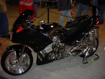

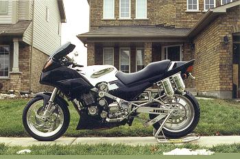

I decided to change the paint.  This was a difficult decision for me, as I really liked the pearl white/silver/red scheme that was the 1988 model year.  At the recommendation of Racer’s Choice, the shop I deal with in Brantford, I went to see Cooper, of Coop’s Custom Scoots.  We chose 1997 Anthracite Pearl, which is a black pearl over Jaguar green with a gold metal flake.  In daylight, you can see the gold hue.  In my opinion, nothing goes better with chrome than black.  It was more a bike-show based decision than anything else; to be honest with you, I liked the original color scheme better, but a black and chrome bike does much better at the shows.  The year 2000 saw her leave drydock with a new paint scheme.
It was now time to name the bike.  It was something I had played around with for a while, and then it had suddenly come to me.  I chose the moniker “Black Sunshine” for a couple of reasons.  First of all, White Zombie is one of my favorite bands.  They have a song called “Black Sunshine” which describes a mythical, evil, black 5.0L Mustang that prowls the highways.  The lyrics matched the reputation of my machine. And finally, my little sister’s nickname was “Sunshine”.  She was a member of the Canadian Olympic Speedskating Team, and was training for the Winter Olympics in Nagano when she died.  Kathleen, or “Kit” as I called her, was one of the fastest speedskaters off of the line in her favorite race, the 500m.  No one could beat Kit when she launched, and the same could be said of Black Sunshine when I hammered the juice.

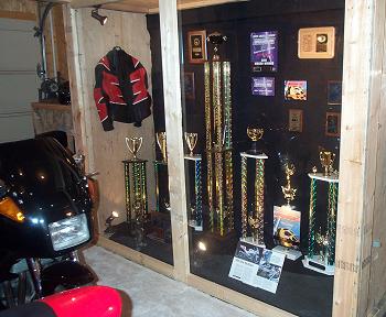

ACCOLADES:
  • 2003 National Motorcycle Show, Toronto;            1st Place, “Foreign Sport Bike”
  • 2003 Barrie Custom Motorcycle Show, Oro;         “Best in Class – Sport Bike”
  • 2003 London Motorcycle Show, Woodstock;         1st Place, “Street Asian”
  • 2003 International Motorcycle Supershow, Toronto; 6th Place, “Builder Class”
  • 2002 Central Ontario Motorcycle Show, Barrie; “Best in Class – Sport Bike”
  • 2002 London Motorcycle Show, London; 3rd Place “Special Interest”
  • 2001 Cycle Craft, Waterloo;                 “Best Import”
  • 2001 Cycle Craft, Waterloo;                 “Best in Class – Sport Bike”
